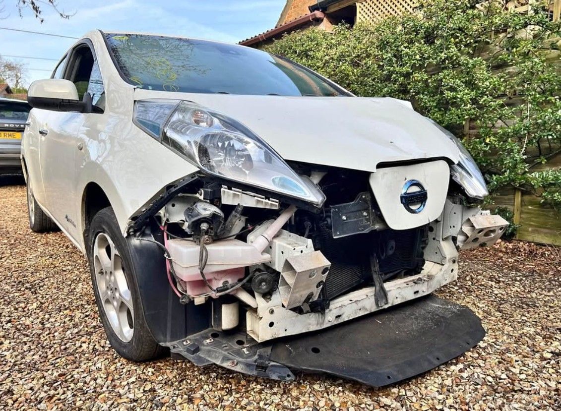

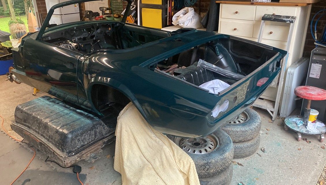

<p dir="auto">Cars as purchased</p>
<p dir="auto"><img src="/assets/uploads/files/1773221851558-img_7453.jpeg" alt="IMG_7453.jpeg" class=" img-fluid img-markdown" /></p>

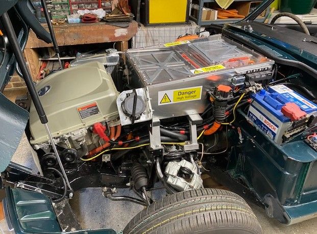

<p dir="auto"><img src="/assets/uploads/files/1773222963604-screenshot-2026-03-11-095505.jpg" alt="Screenshot 2026-03-11 095505.jpg" class=" img-fluid img-markdown" /></p>

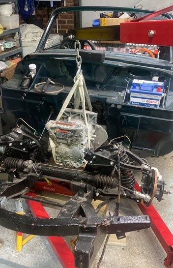

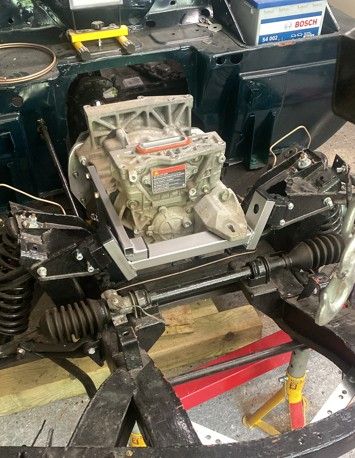

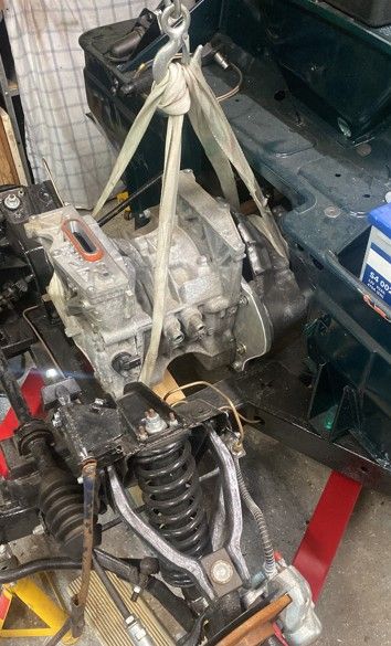

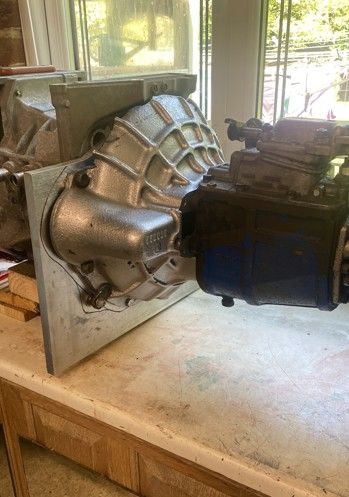

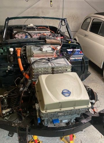

<p dir="auto">Leaf motor bolted to original Overdrive gearbox means I'll be able to run in 3rd or 4th all the time with overdrive being selected where needed (although not in reverse - overdrives have a habit of exploding when going backwards!). Adaptor plate still to be trimmed.<br />
<img src="/assets/uploads/files/1773223264069-gearbox.jpg" alt="Gearbox.jpg" class=" img-fluid img-markdown" /><br />

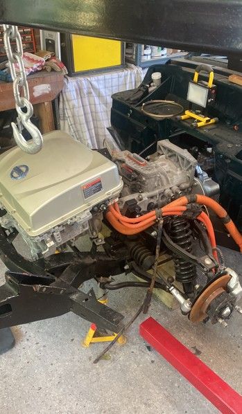

Offering it up. Little clearance but does fit using original gearbox / engine mounts.<br />
<img src="/assets/uploads/files/1773224111473-offering-1.jpg" alt="Offering 1.jpg" class=" img-fluid img-markdown" /> <img src="/assets/uploads/files/1773224118930-offering-2.jpg" alt="Offering 2.jpg" class=" img-fluid img-markdown" /> <img src="/assets/uploads/files/1773224127216-offering-3.jpg" alt="Offering 3.jpg" class=" img-fluid img-markdown" /><br />

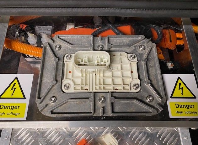

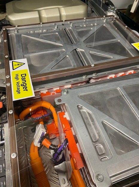

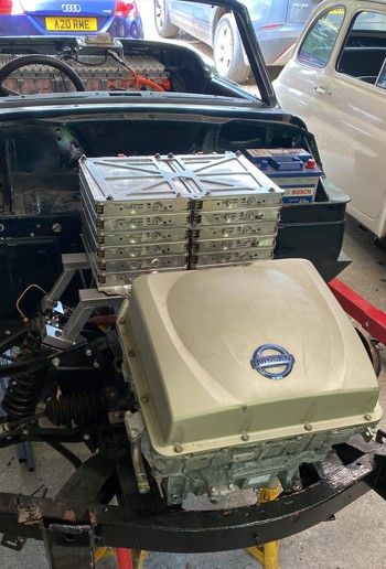

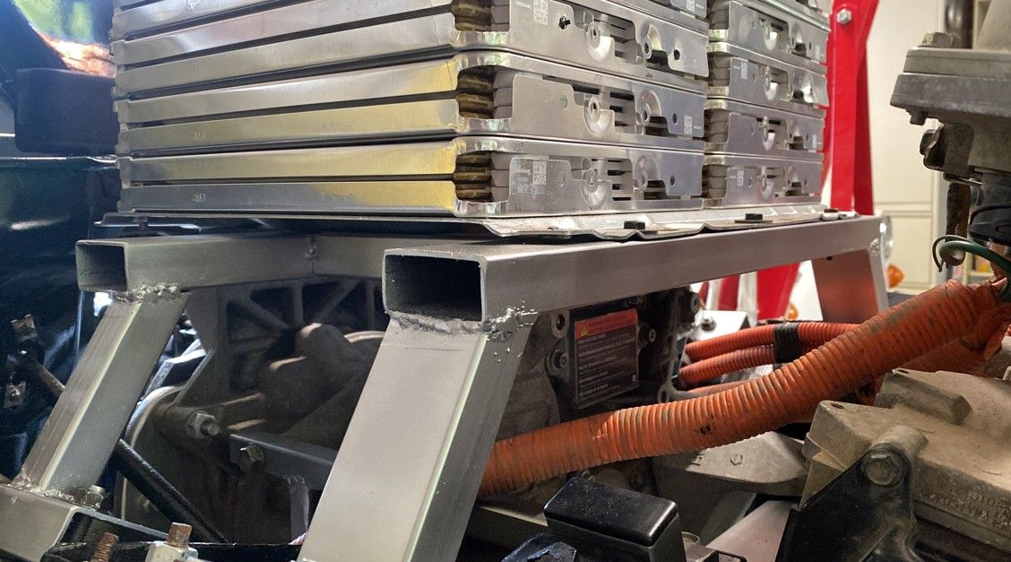

First batteries fitted.<br />
<img src="/assets/uploads/files/1773224216846-battery-1.jpg" alt="Battery 1.jpg" class=" img-fluid img-markdown" /> <img src="/assets/uploads/files/1773224221857-battery-2.jpg" alt="Battery 2.jpg" class=" img-fluid img-markdown" /> <img src="/assets/uploads/files/1773224459738-more-batteries.jpg" alt="More batteries.jpg" class=" img-fluid img-markdown" /><br />

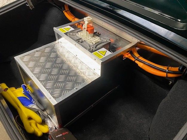

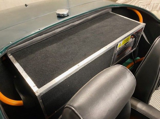

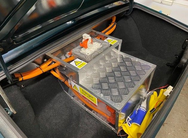

Rear batteries shoehorned in.<br />
<img src="/assets/uploads/files/1773224353297-rear-batteries.jpg" alt="Rear batteries.jpg" class=" img-fluid img-markdown" /> <img src="/assets/uploads/files/1773224360866-rear-batteries-2.jpg" alt="Rear batteries 2.jpg" class=" img-fluid img-markdown" /><br />

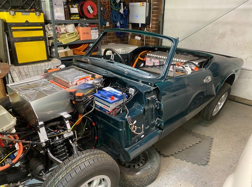

First test drive - it does actually move under it's own steam.<br />
<img src="/assets/uploads/files/1773224948485-vkjy3940.jpg" alt="VKJY3940.JPG" class=" img-fluid img-markdown" /><br />

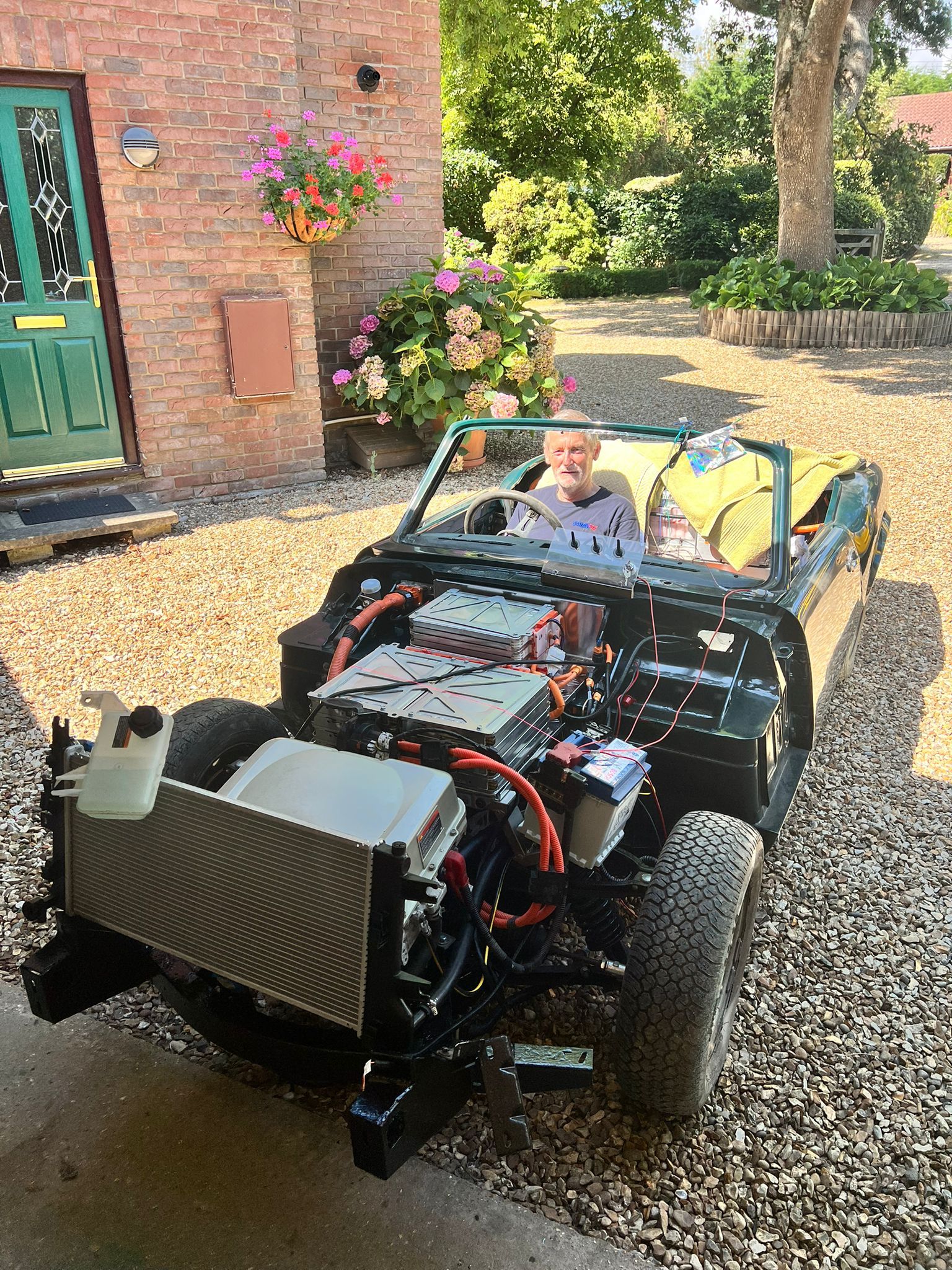

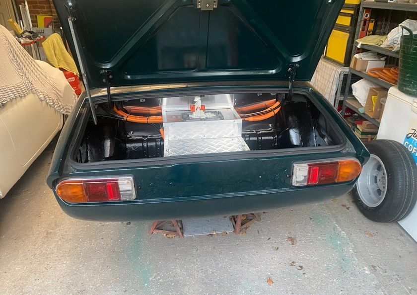

Further progress - it does all fit...<br />

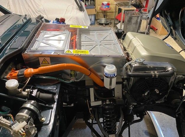

<img src="/assets/uploads/files/1773224530690-it-does-fit-1.jpg" alt="It does fit 1.jpg" class=" img-fluid img-markdown" /><br />

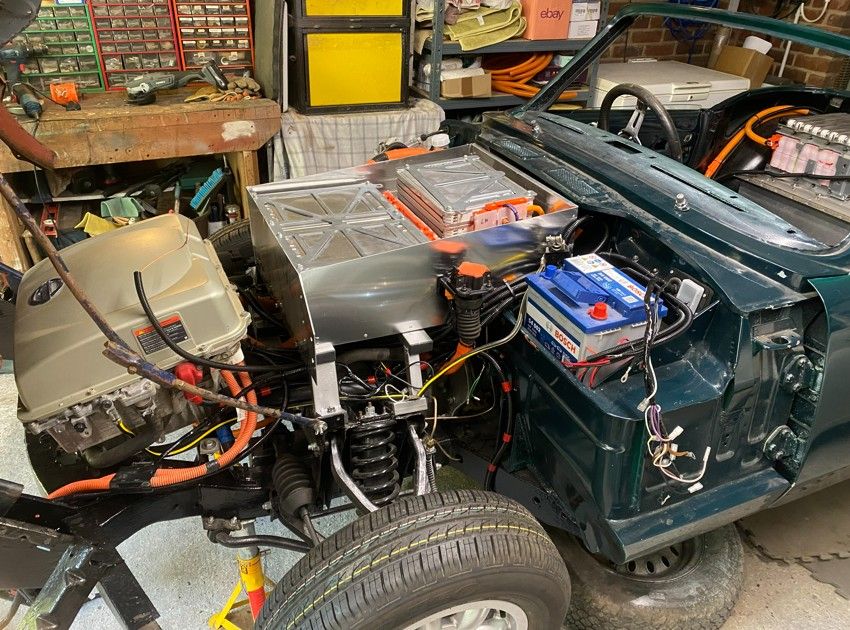

Classic mini radiator with electric fan appears to offer more than enough cooling<br />
<img src="/assets/uploads/files/1773224795023-it-does-fit-2.jpg" alt="It does fit 2.jpg" class=" img-fluid img-markdown" /><br />

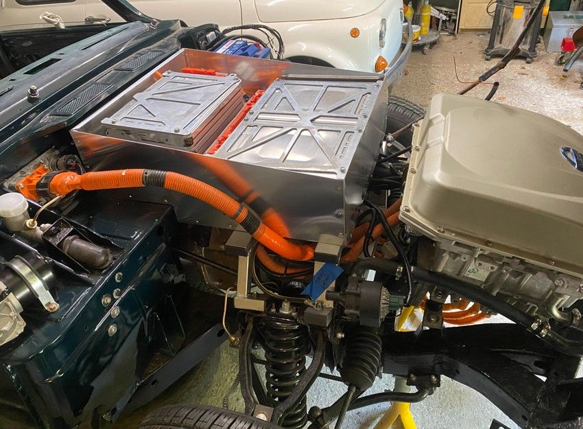

(/assets/uploads/files/1773224542032-it-does-fit-2.jpg) <img src="/assets/uploads/files/1773224547774-it-does-fit-2.5.jpg" alt="It does fit 2.5.jpg" class=" img-fluid img-markdown" /> <img src="/assets/uploads/files/1773224557971-it-does-fit-3.jpg" alt="it does fit 3.jpg" class=" img-fluid img-markdown" /> <img src="/assets/uploads/files/1773224565253-it-does-fit-4.jpg" alt="it does fit 4.jpg" class=" img-fluid img-markdown" /> <img src="/assets/uploads/files/1773224575195-it-does-fit-5.jpg" alt="it does fit 5.jpg" class=" img-fluid img-markdown" /> <img src="/assets/uploads/files/1773224583620-it-does-fit-6.jpg" alt="it does fit 6.jpg" class=" img-fluid img-markdown" /><br />

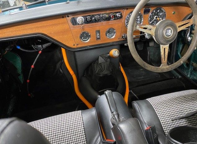

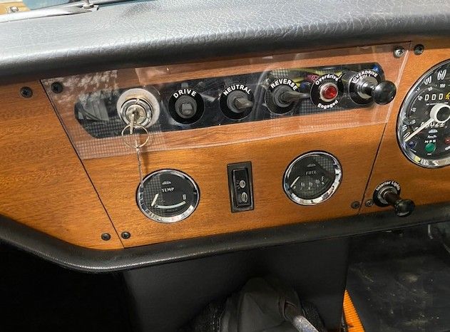

Dashboard has relevant switches etc. Overdrive engaged warning light will hopefully remind me not to select reverse if it's engaged.<br />
<img src="/assets/uploads/files/1773225111495-dash-2.jpg" alt="Dash 2.jpg" class=" img-fluid img-markdown" /><br />
OLED display installed in centre of main guages. (<a class="plugin-mentions-user plugin-mentions-a" href="/user/isak">@<bdi>isak</bdi></a> - I have sent you an email recently regarding this compnent failing - everything is working i.e. I can engage forwards, reverse etc but as OLED has stopped working (only after about 6 uses) I can't tell what mode I'm in, state of charge or braking status so your advise would be useful).<br />
<img src="/assets/uploads/files/1773225324746-dash-1.jpg" alt="Dash 1.jpg" class=" img-fluid img-markdown" /></p>
