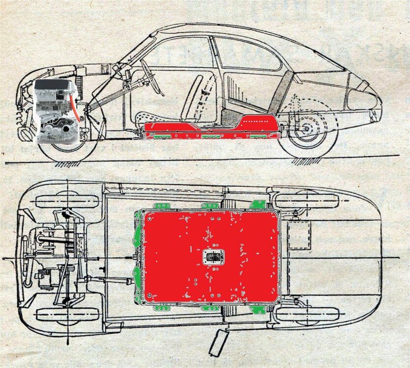

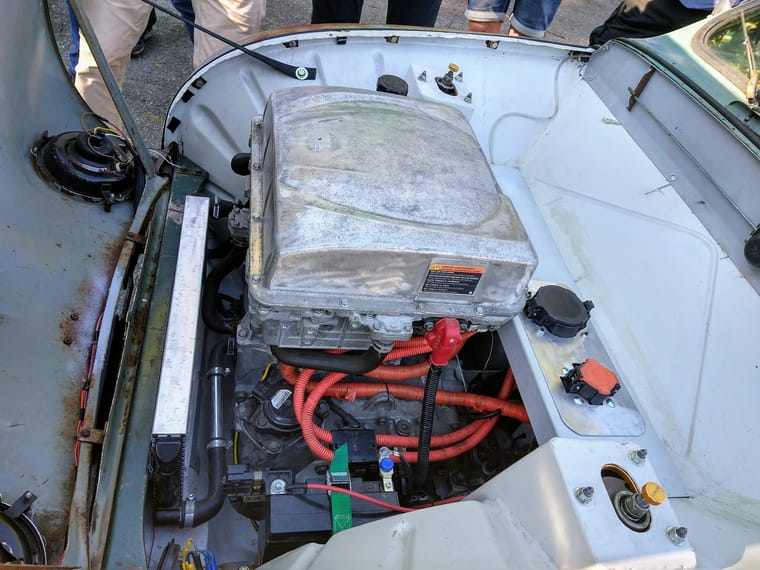

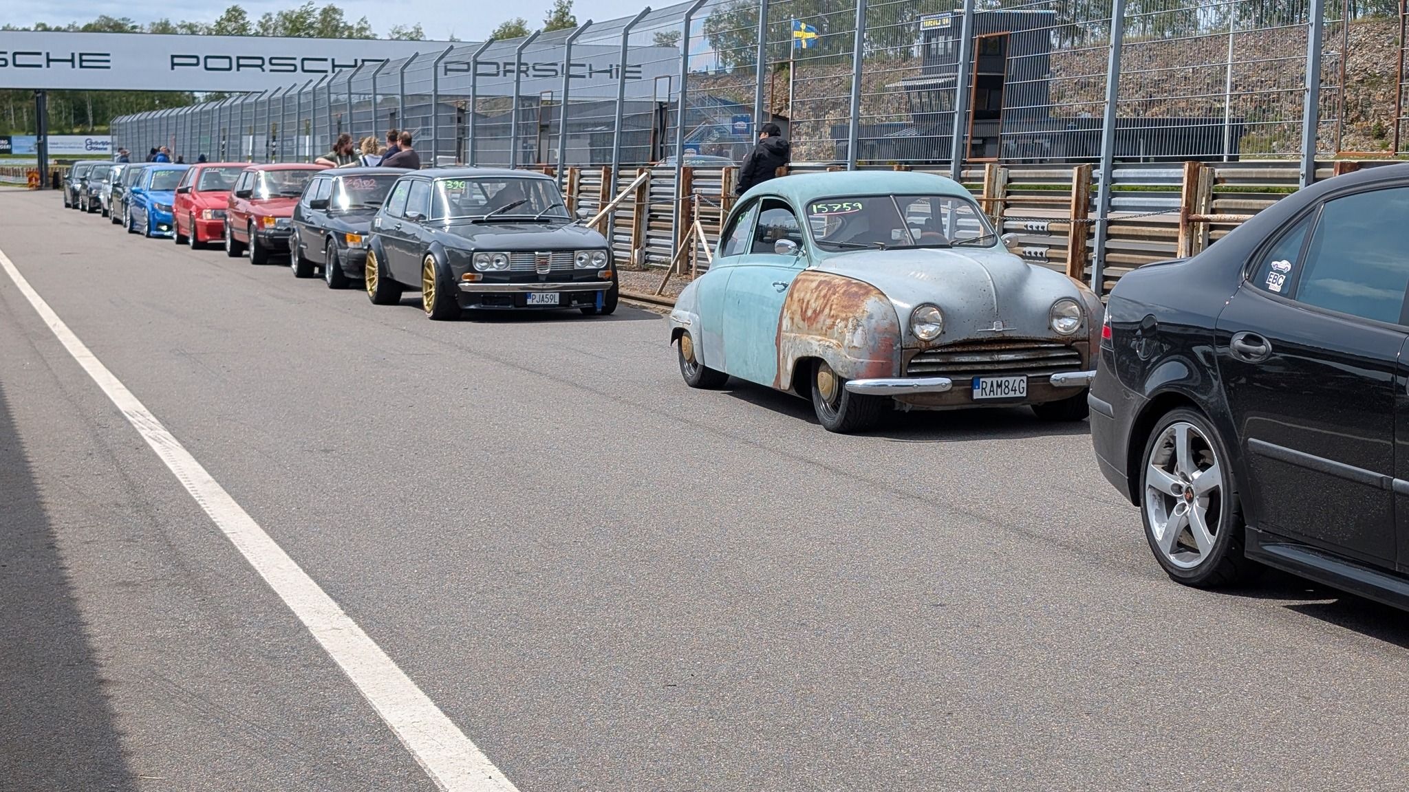

    I will not make a tread here but can still share the build i made on one of the old first saab's ever.
    Saab 92 1953 . Mine is a complete new modern take on it with front and rear from 9-3.

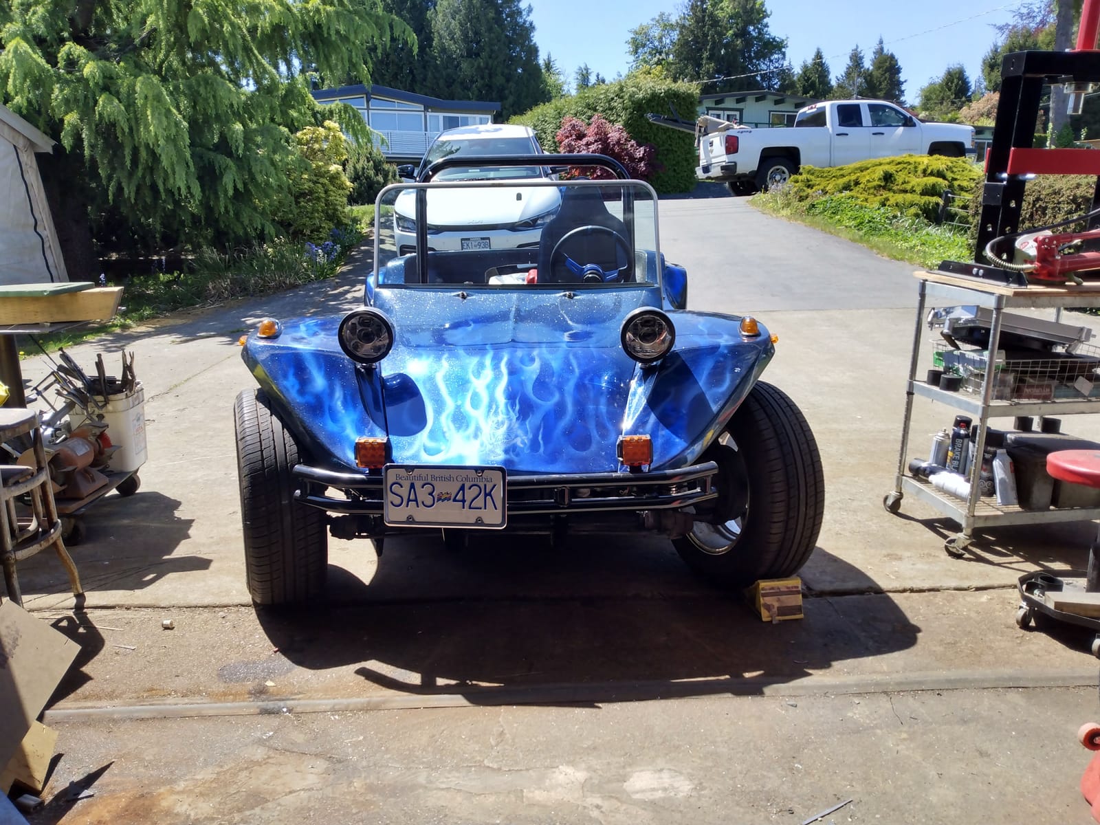

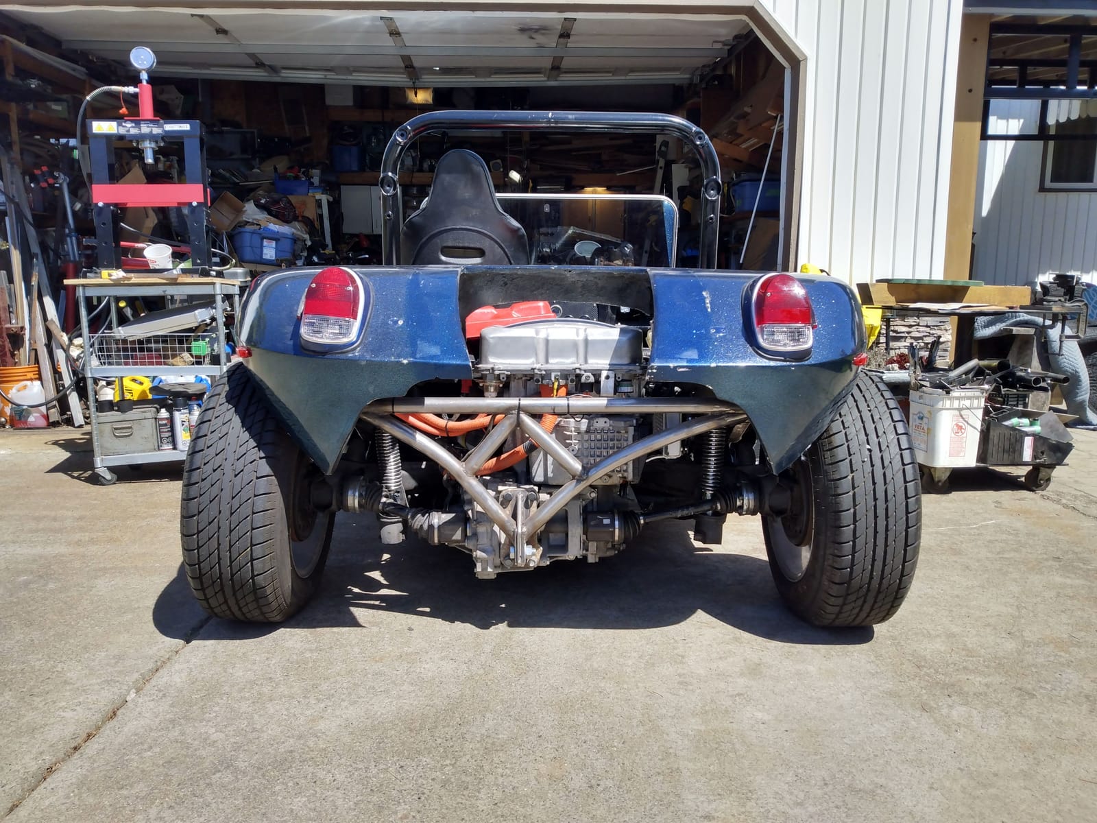

              @Saabel Great project. I did something similar with a dune buggy by replacing the centre of the frame with a frame to hold the Leaf battery. For my next conversion I am hoping to use a 2023 214 hp Leaf motor and stack with the Resolve controller. I looks like if I do this I will not be able to use the Chademo port for DC charging. Anton Arnqvist at Resolve mentioned that he thought you had solved this issue. Is there any workaround that would allow DC charging? I really appreciate the fast charging on my other two conversions but for this one I want the 214hp motor which was only available after 2019, I also want to use a 62kw battery. Any thoughts would be helpful.

                #7
                @DTL HI , long between the logins here 🙂 The solution is to use the old Leaf top with Typ1 charger this one will still support chademo ( see manual) . I use the new 214hp inverter and the old 110hp top . The typ1 can probably be modified to typ2 charger if needed but i use a typ1 to typ 2 cable
