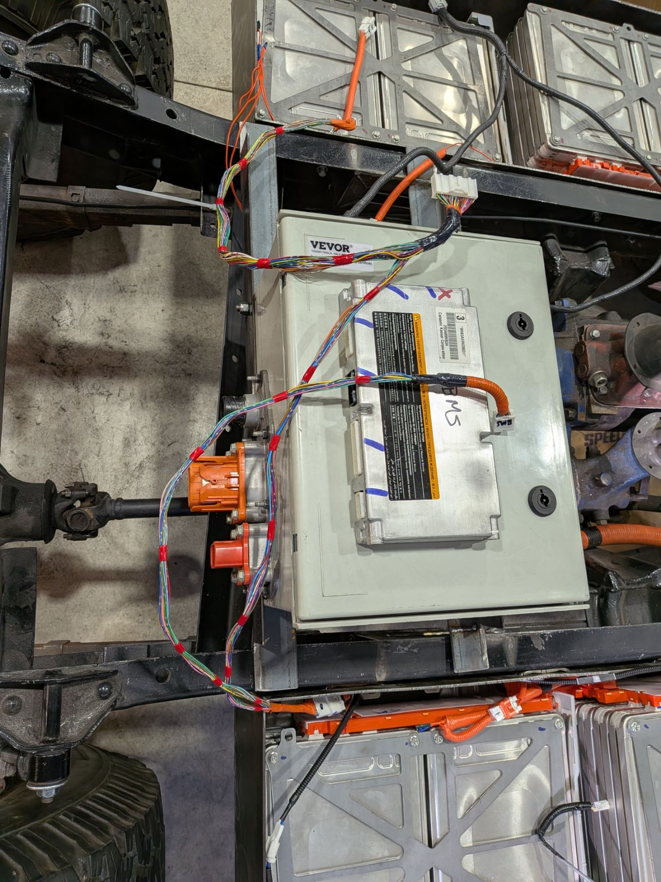

    BMS with all the harnesses attached. Not sure if all these connections are necessary for our build but we're going with it until we hear otherwise. Anyone want to comment on what's necessary and not? I'm not sure how to invoke the "@isak" link for his response. It would be great if someone could help me with that.

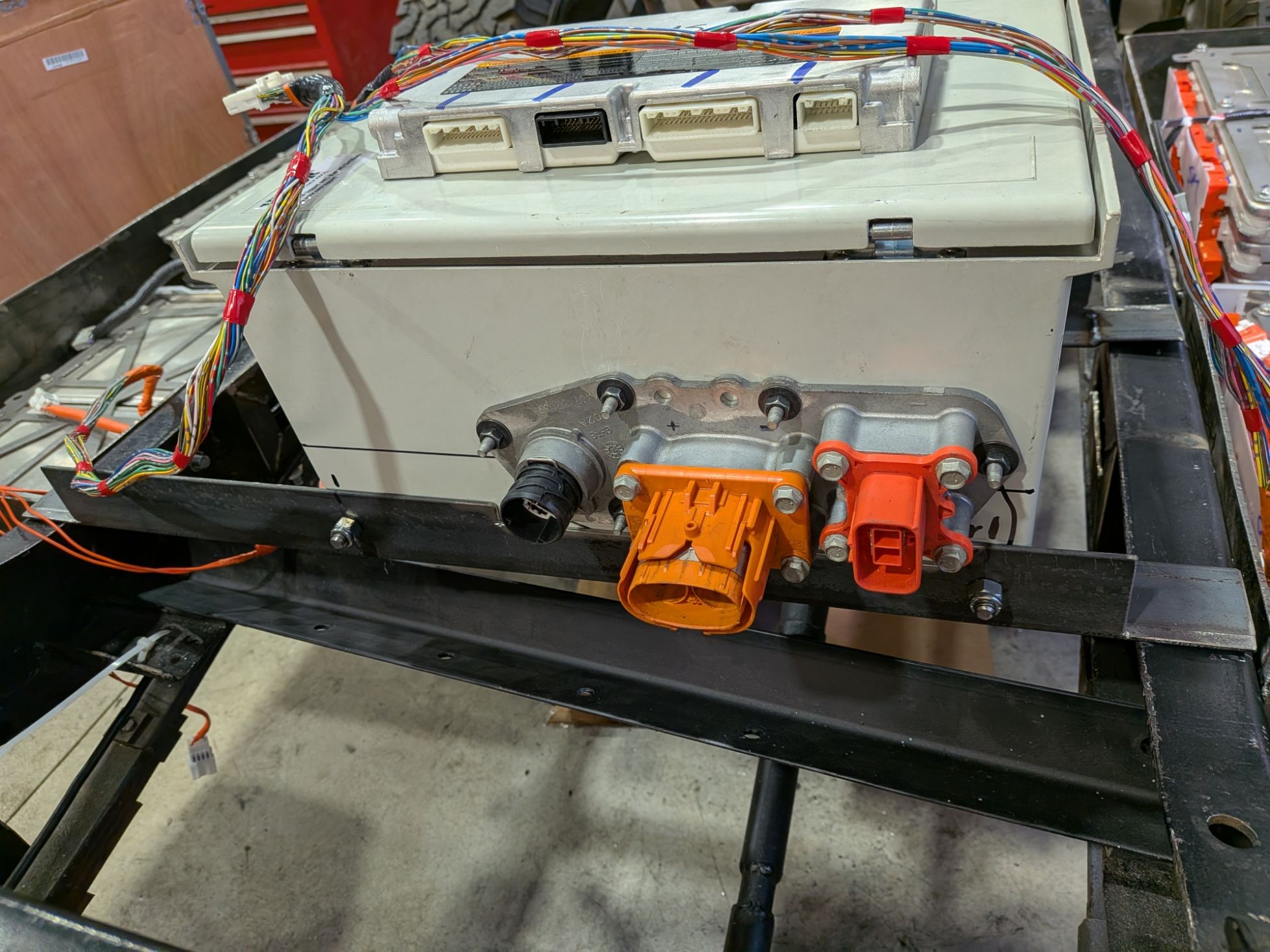

        I went with a pre-made box that has good sealing for all the Leaf battery command wiring. You can't see it from the picture, but the snout that connects to the motor cable is toward the top of the box in the picture. Not sure what wiring is necessary here but it's all connected as it once was. The box will actually face down once it's all wired, sitting between the frame side to side and between the transfer case and rear battery.

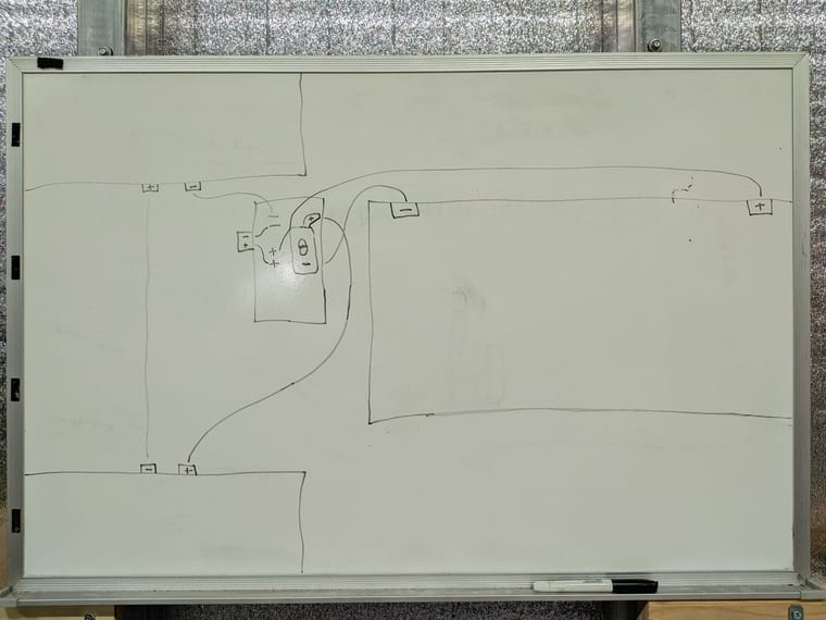

            My truly artistic drawing of the battery cable wiring diagram based on the original battery wiring. I ordered LC-40 welding cable 350amp quick connectors to put in the middle of each battery cable in case a battery box needs to be removed.

                Separating some of the BMS wiring loom to reach the three separate boxes without needing extension wiring. Considering how we want the battery boxes to be completely modular, I still need to consider extension wiring plugs for quick disconnect.

                    You'll notice the snout attached to the box is upside down. It will be right side up when installed since the door will be facing down. Zooming in you can see the + and - marks just above the orange plug. The Resolve-EV controller wiring will plug into the round black plug. The reddish connector originally plugged into the harness that went through the floor of the Leaf. I guess that just stays unconnected, although there are a couple wires that plug into the hardware within the box connected to this plug.

                          @leshall89 All the BMS connectors are necessary except the ones going to the relay that controls the resistive heaters that sit on the cells (not all leaf packs come with resistive heaters). It's the cables that go from the BMS to a rectangular black box. Temperature sensor cables connector and the 12V and CAN connector and the rest of the balancing wires are all needed for the BMS to not throw a fit 🙂
