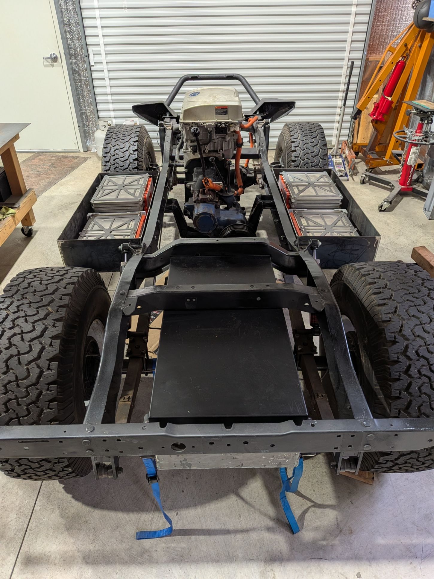

      This is what we came up with for battery installation. We wanted to keep the batteries within their respective configurations. A CJ5 doesn't have much empty space laying around and placing all the batteries in the rear was not a good strategy for weight distribution.

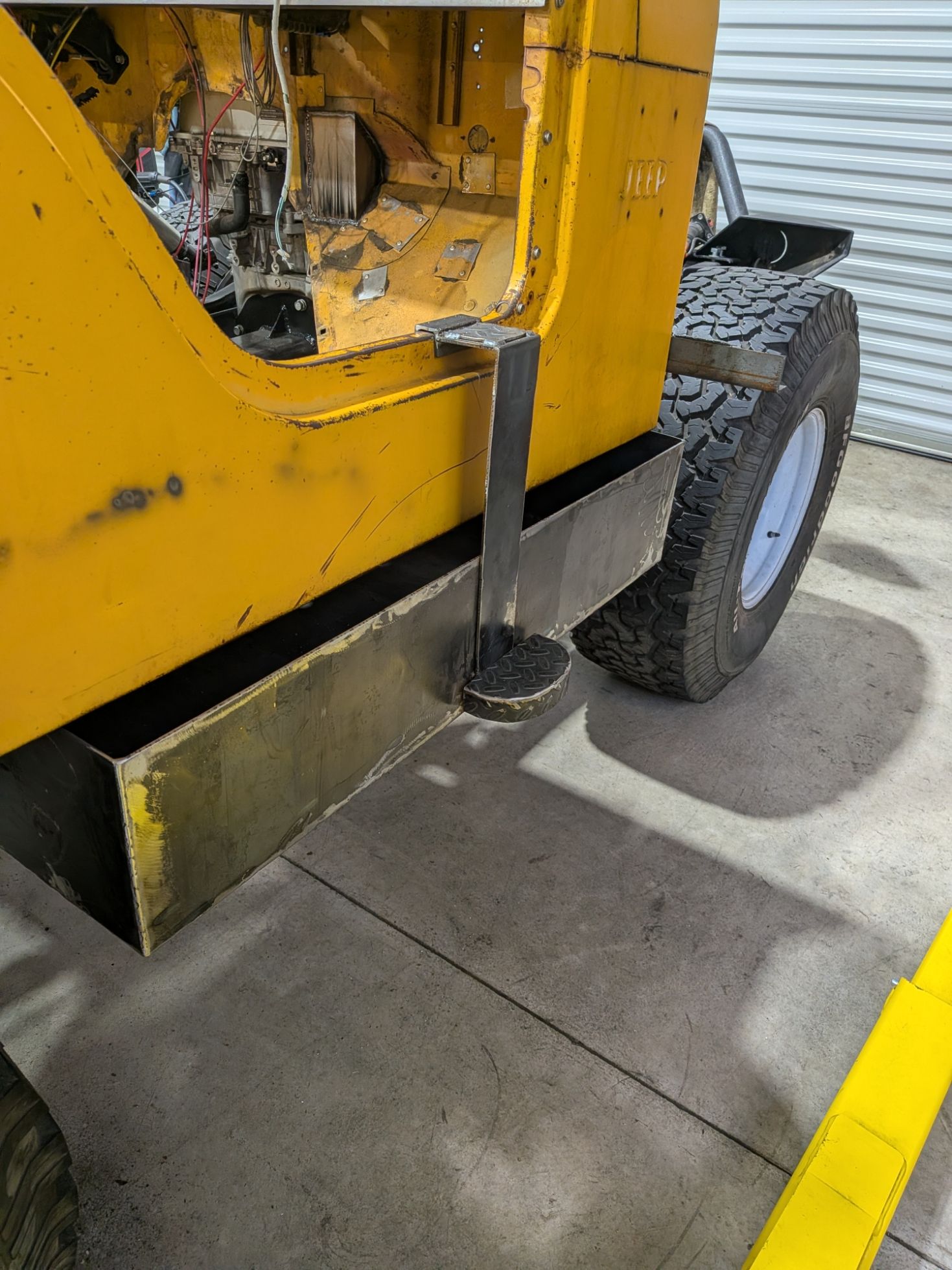

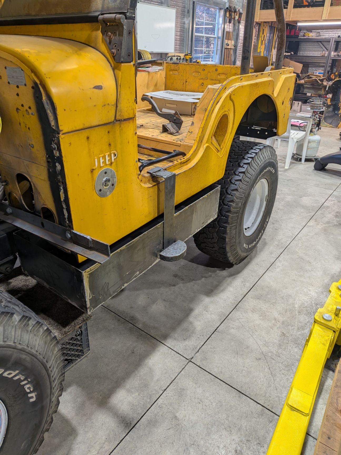

            This is what we came up with for adding integrity to the side battery boxes. Bolted to the side of the box, we considered the need to remove a module, which this allows without removing the body, and includes a very stable step up. We won't truly know how stable the driving is until it's on the road, but we're very optimistic it will have good driving manners with this configuration.

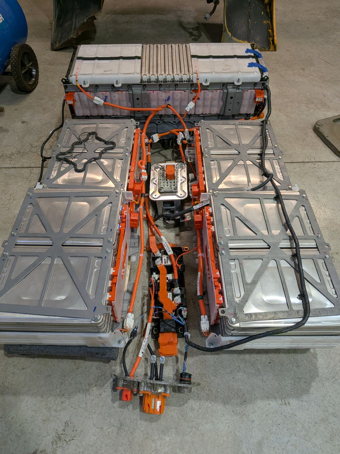

                This is the battery layout with all the wiring connected in its general location. I believe some of this wiring won't be needed due to our very simple build; manual steering, manual brakes, no A/C, no power windows, no heated seats, etc.
                https://forum.resolve-ev.com/user/isak, what are your thoughts on what wiring isn't necessary?

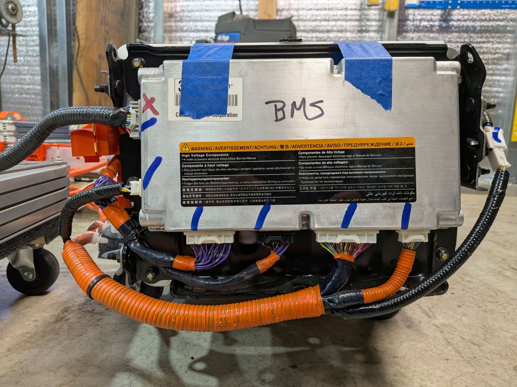

                    BMS with all the harnesses attached. Not sure if all these connections are necessary for our build but we're going with it until we hear otherwise. Anyone want to comment on what's necessary and not? I'm not sure how to invoke the "@isak" link for his response. It would be great if someone could help me with that.

                                        @ianlighting Awesome, thank you for your input. I wasn't sure what that plug was used for and we certainly won't have any heating or cooling, just open cockpit for warm weather excursions.

                                          @leshall89 All the BMS connectors are necessary except the ones going to the relay that controls the resistive heaters that sit on the cells (not all leaf packs come with resistive heaters). It's the cables that go from the BMS to a rectangular black box. Temperature sensor cables connector and the 12V and CAN connector and the rest of the balancing wires are all needed for the BMS to not throw a fit 🙂
