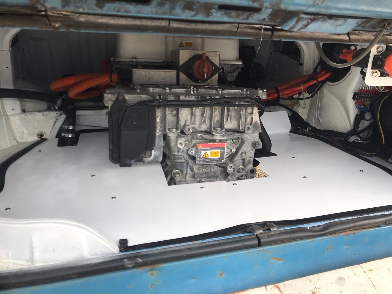

    My build is kinda ‘complete’, although there’s now a long list of improvements I’m working on.
    It’s 2014 80kW Leaf based but with later 62kWh battery.
    Checked and authorised by DVLA, so now registered at electric in the UK.
    I’ve done 1200 miles as an EV so far.
    Main build thread is on Open Inverter forum as this forum didn’t exist when I started.
    Currently looking at switching the annoying vacuum pump for a silent ibooster for the brakes.

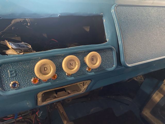

              Here’s my D N R panel I just finished. Matches the other dashboard stuff. Knobs still to be finished off with caps, but all working. Uses ESP32 to monitor CANbus.
              @isak - any chance you can increase the file size limit for uploads. It’s too low for my default iPhone images so if I want to upload an image I have to convert and that’s a pain.

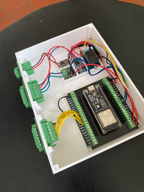

                ESP32 box to control tally lights. Plus other things.

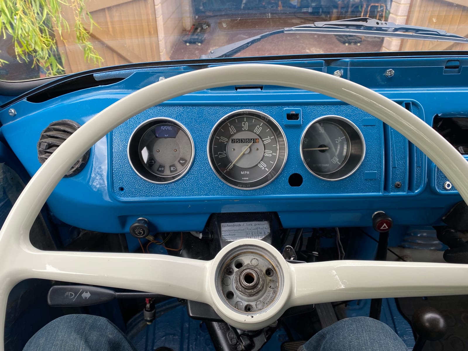

                    Integrated the oled display where my original fuel gauge used to be - left gauage.
                    The battery charge on the right is a butchered speed hut dial with a different fascia. Not working right now. Might have broken it why I was ‘improving’ it.

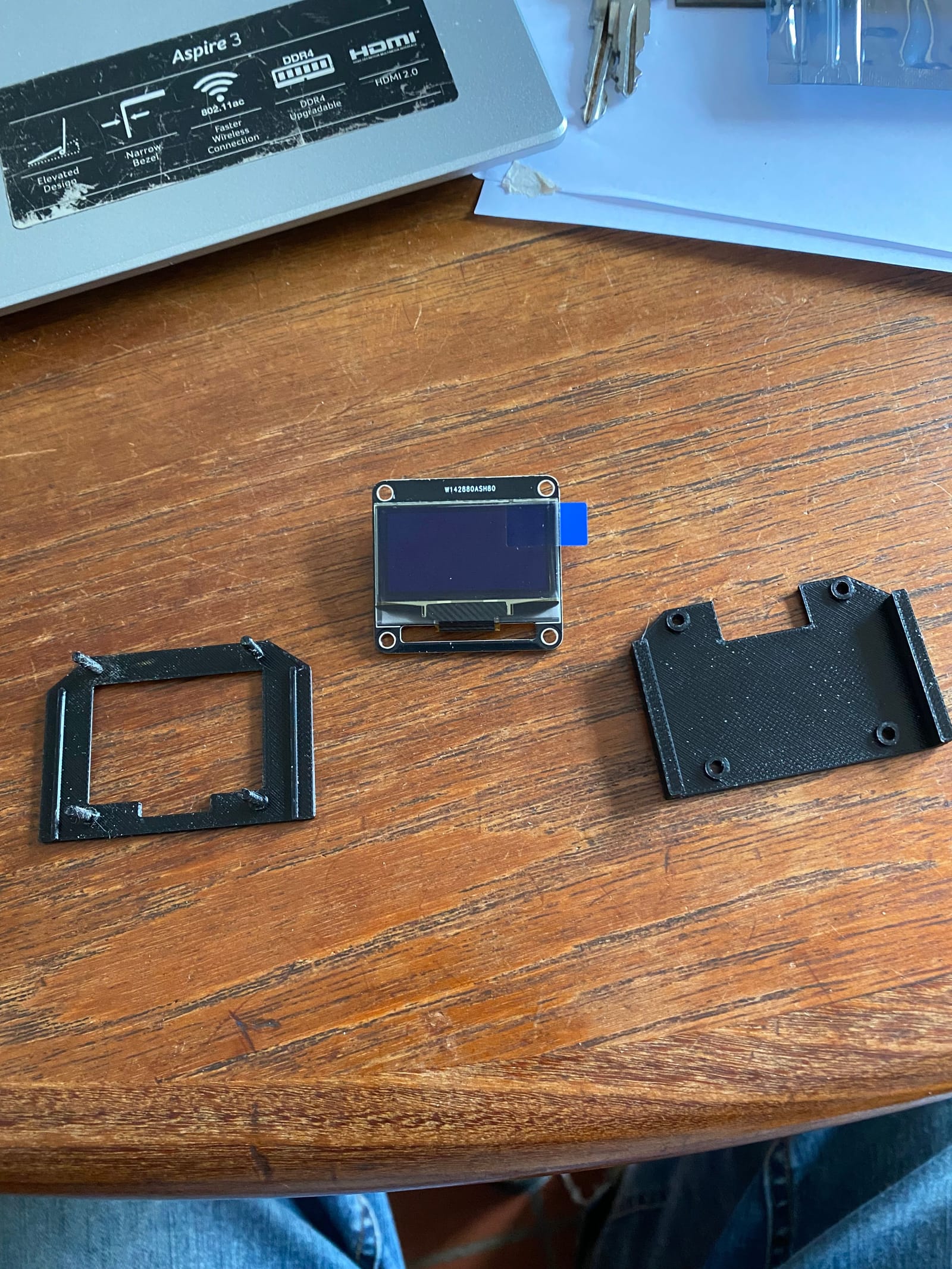

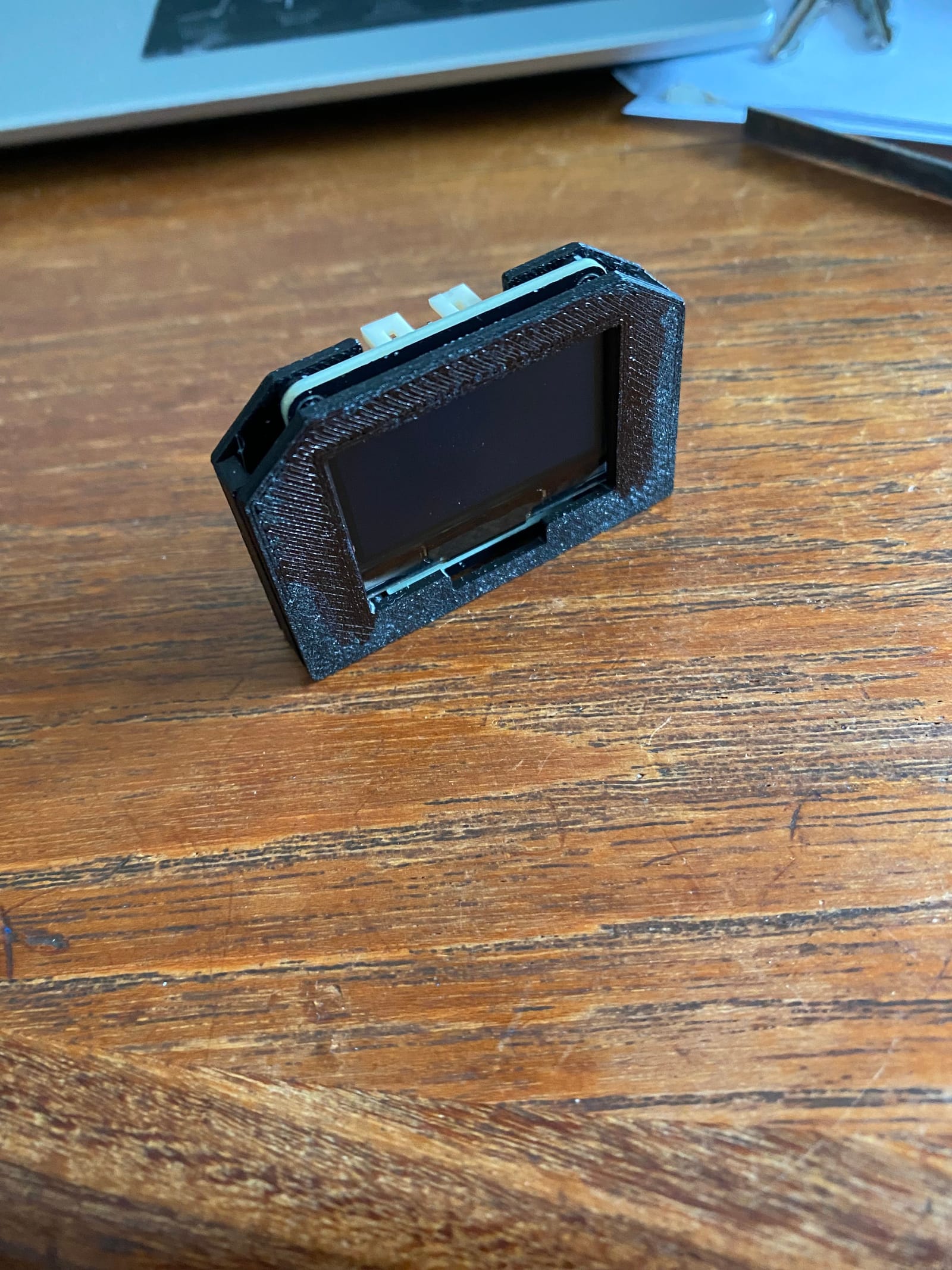

                          3D printed a clip together case, then glued to the guage.
