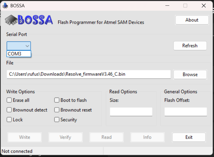

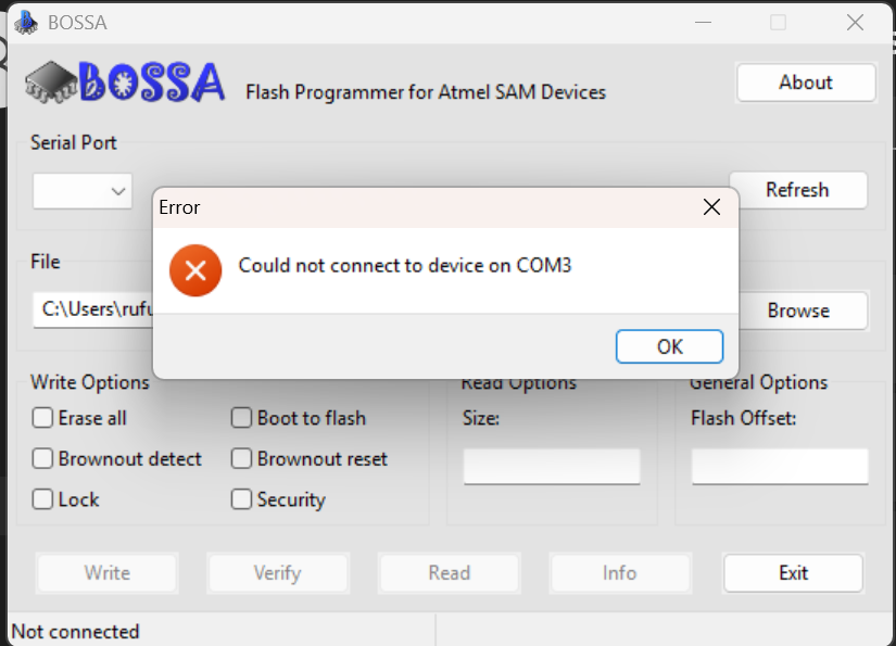

    Hi, all.
    I am updating my controller and following the online instructions.
    My controller appears as COM3 when I connect it and refresh the BOSSA app.
    When I select COM3, the error message appears as required.
    Then after I close the error message, I do not get a new COM port number as described in the instructions.
    Thanks in advance.
    Rufus

      Could you send a screenshot of what it looks like? Do you have a Resolve controller with an USB-C or micro USB connector?

        Hi, thanks for your quick response.
        micro-usb connector, screenshots attached

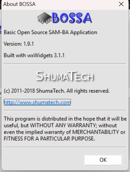

            tried unsuccessfully with a second windows machine on the same BOSSA version
