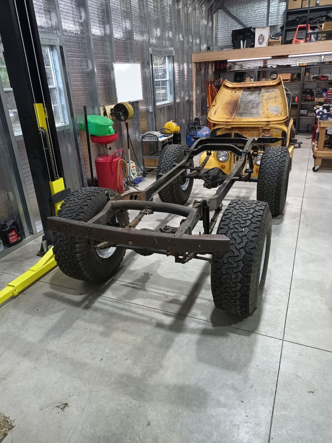

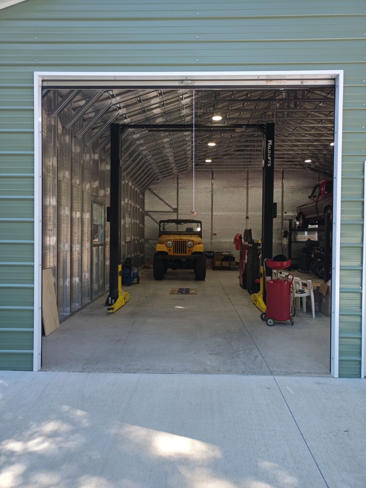

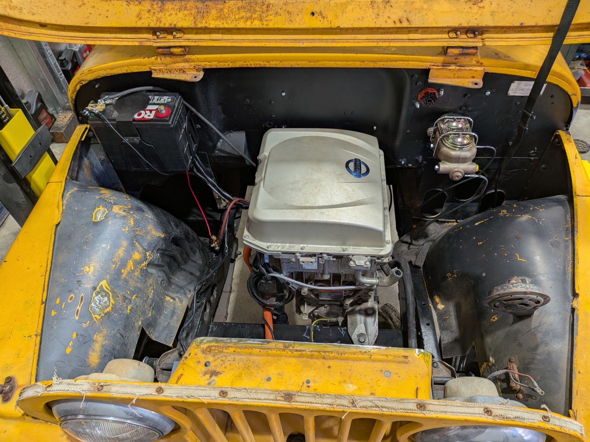

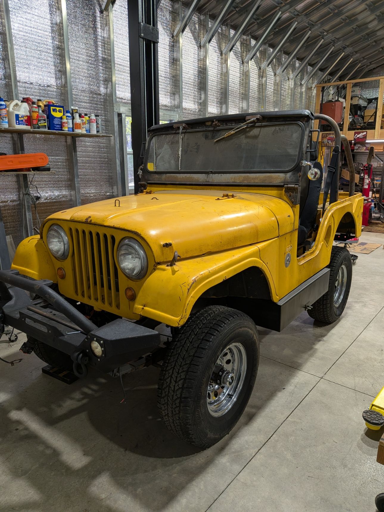

    We're converting this old Jeep to electric via 2015 Nissan Leaf. This is first time effort with electric conversion.
    Started this process about a year ago in my house garage, ended up building a new 30x40 workshop so we could have a 2-post car lift to help with the conversion. I'll be adding pics as we progress. Cheerio! Les and Ethan, northeastern California

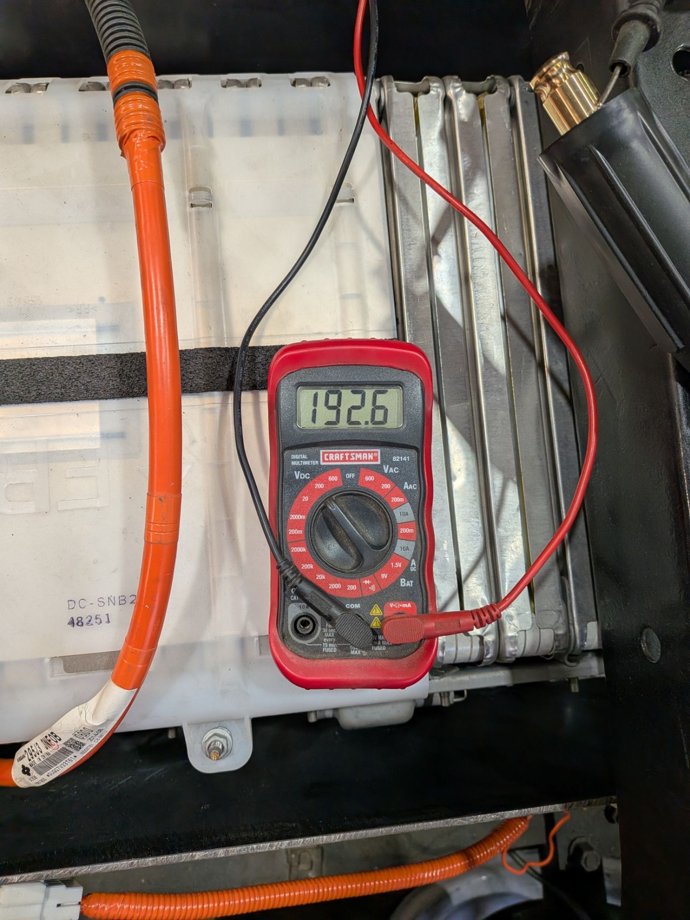

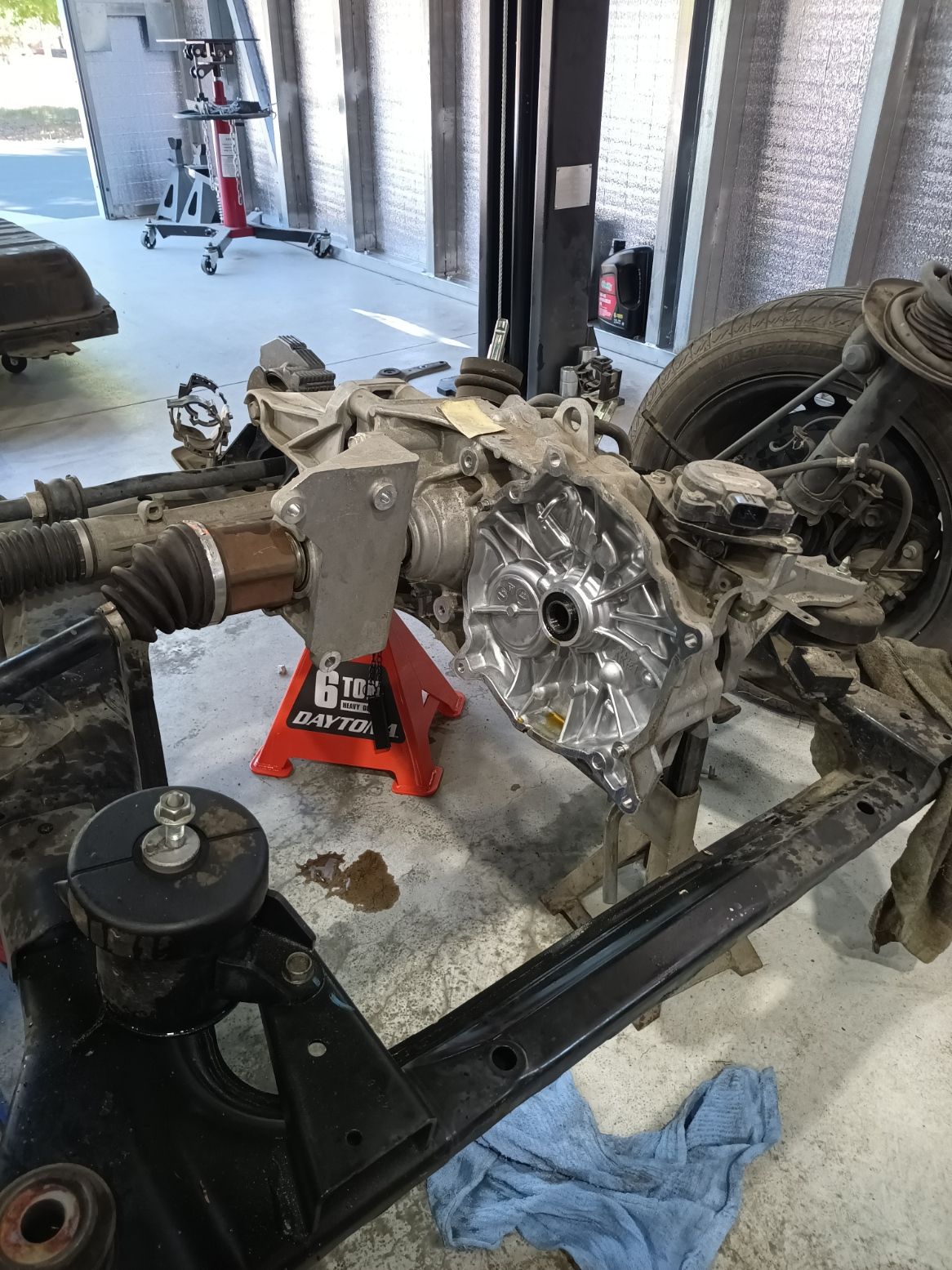

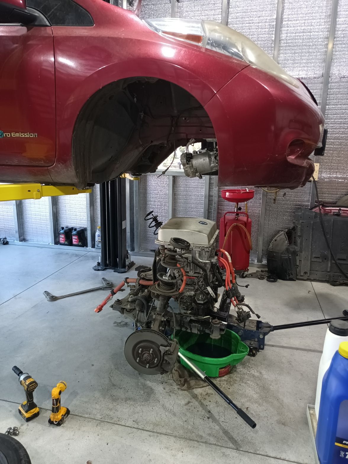

              The battery pack was in good condition, 10 of 12 bars, car had a 75 mile range. I drove it quite a bit before removing drive train. Got the whole car for $3200.

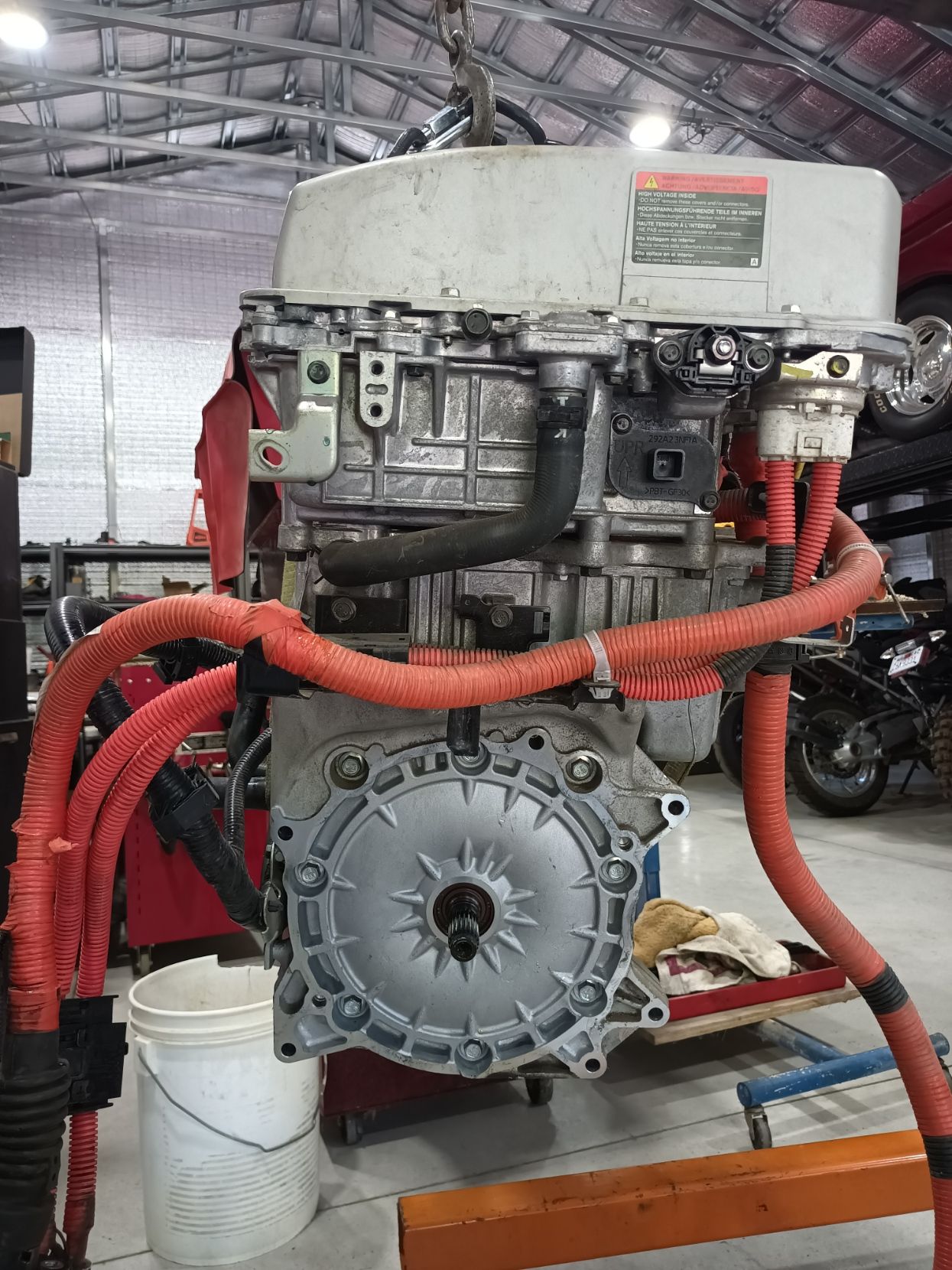

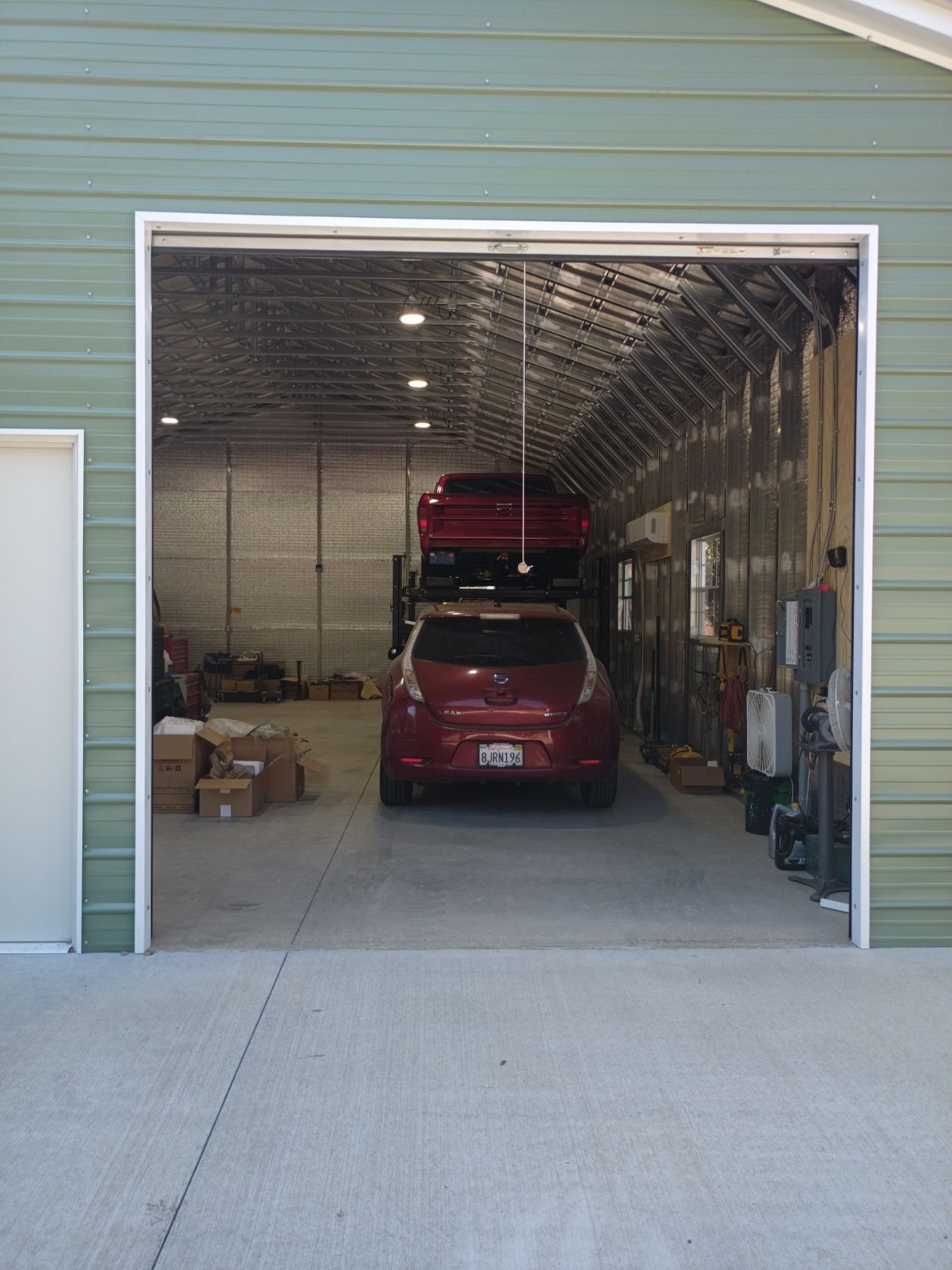

                  Dropping the whole front end down is an easier way to remove the motor. I know, having a car lift isn't something most DIYers have, so we're fortunate.

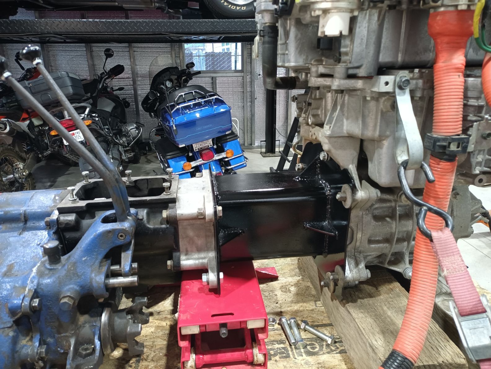

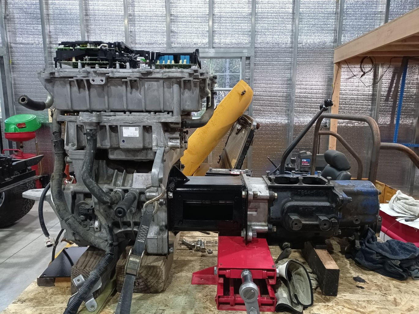

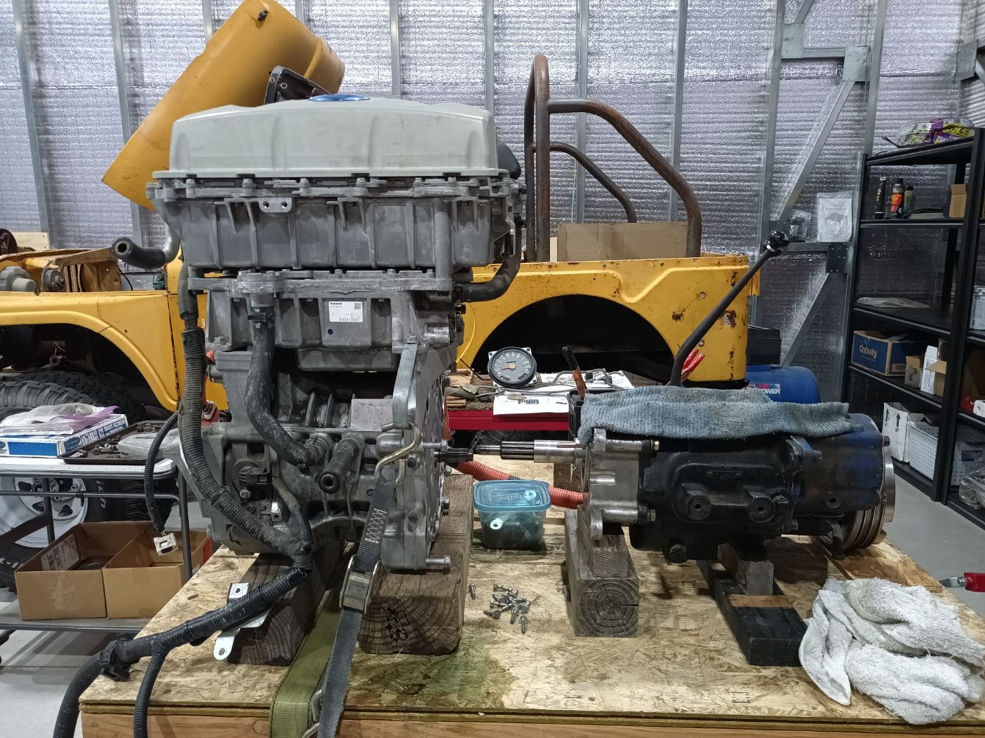

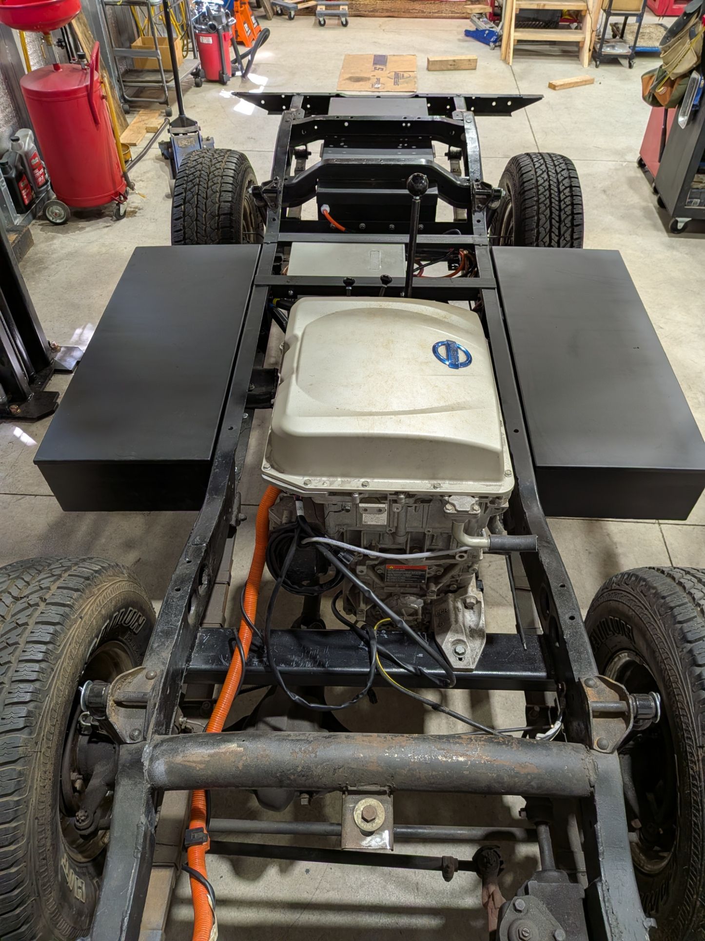

                        We're mating to the original 3 speed trans, 2 speed transfer case for full gear driven and 4x4 operation.
                        • L Offline
                          L Offline
                          leshall89
                          #12
                          • L Offline
                            L Offline
                            leshall89

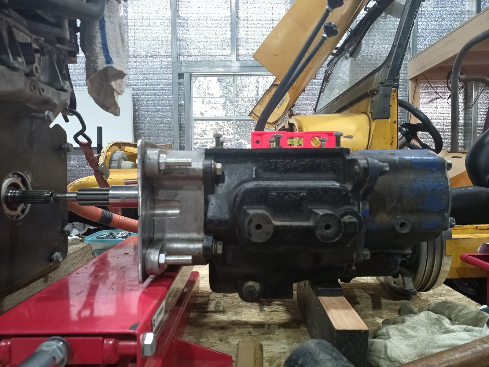

                            #13
                            Lining it up for proper dimension check.

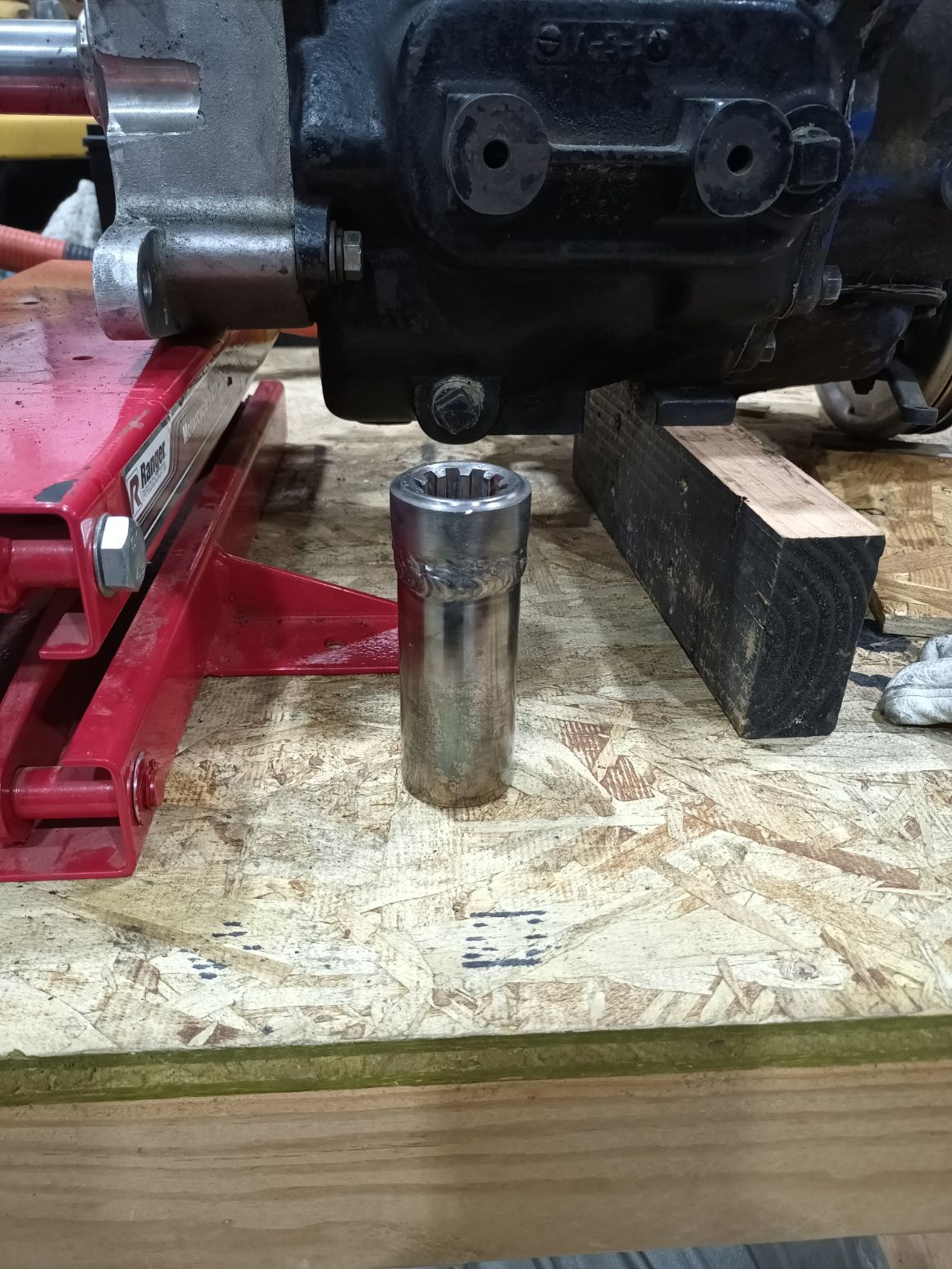

                                #15

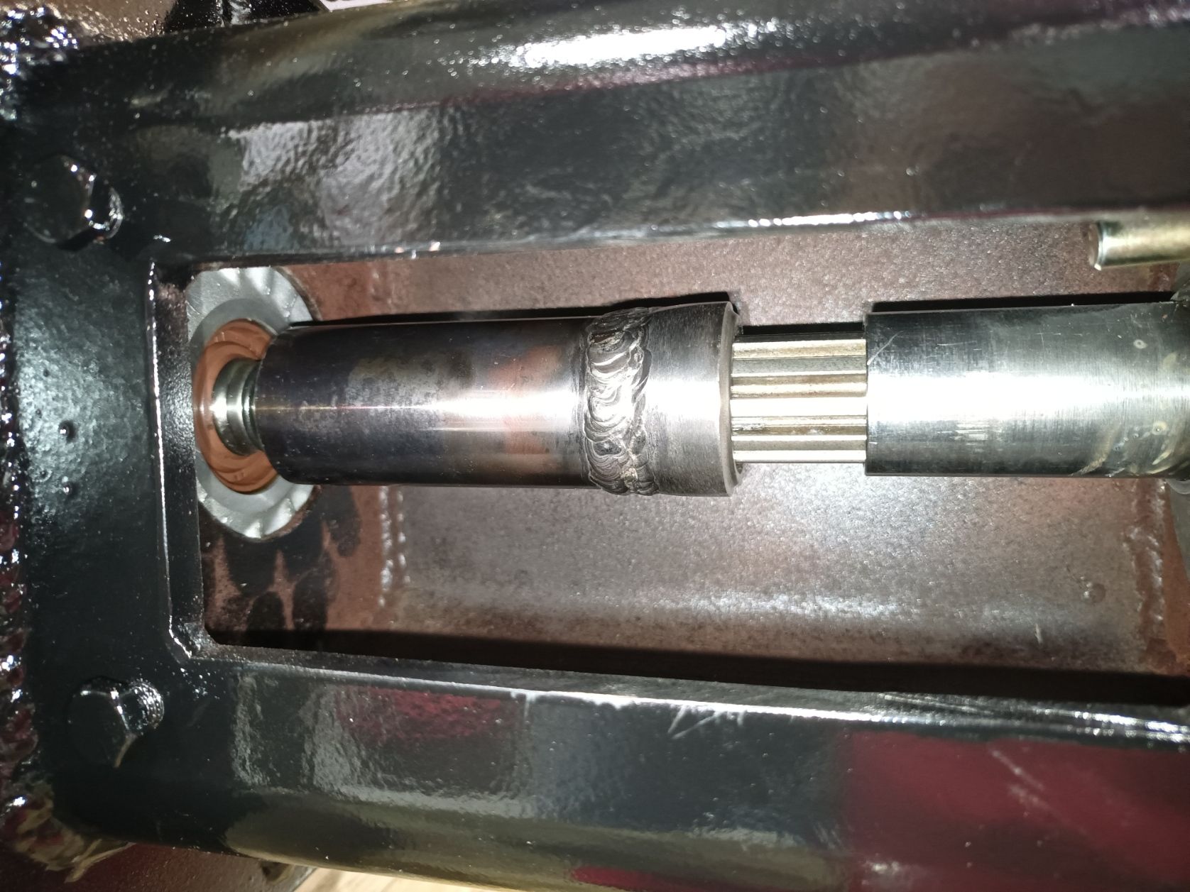

                                Coupler from Brat industries welded to the clutch gear. None of this build would be possible without Ethan, my brother the welder/fabricator. His skills are off the hook!

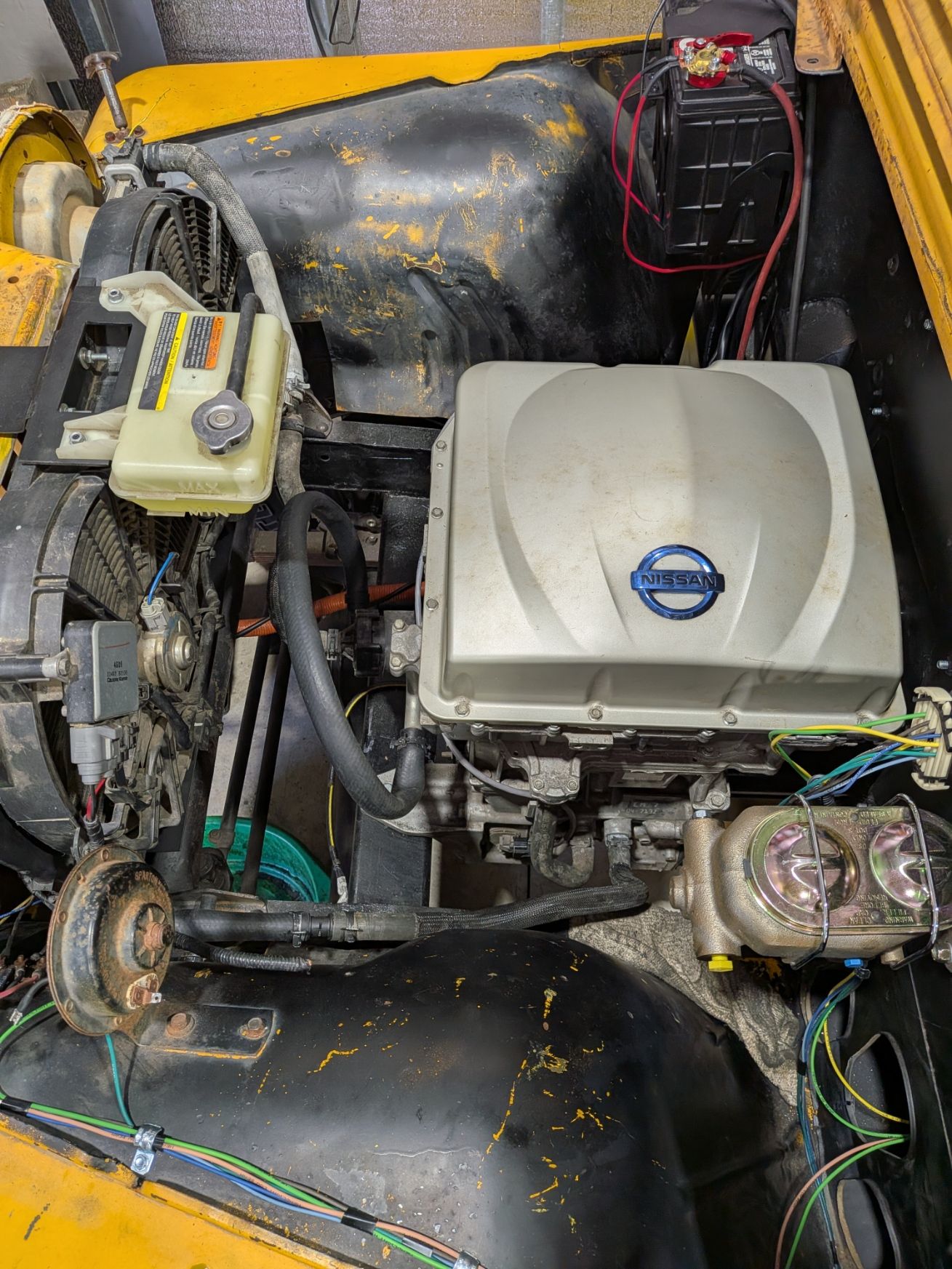

                                    Hard to see, but there is a window on the side of the "bell housing" that shows the coupler location.
